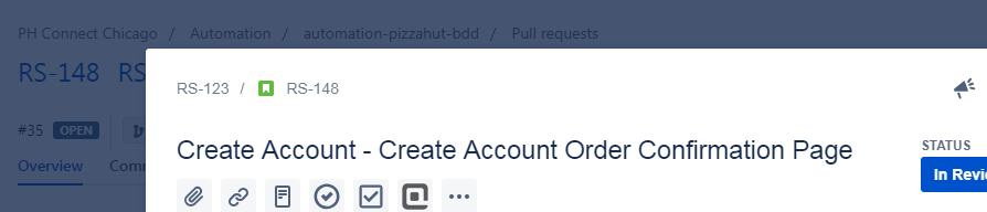

We definitely do have the two products connected; we can click the ticket number in a pull request and it pops open a modal with the Jira ticket;

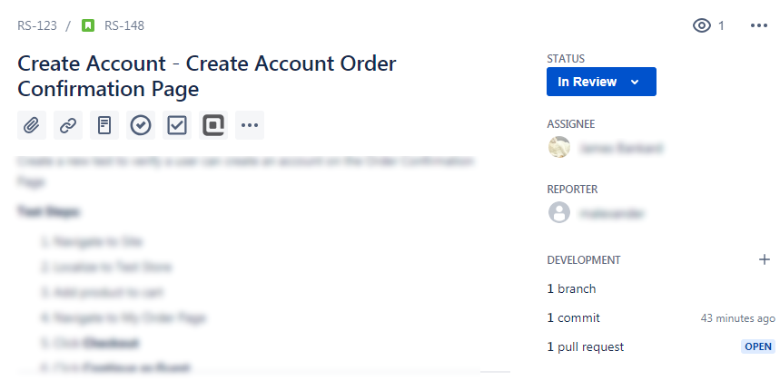

and in Jira we can see branches, etc. in the Development section of a ticket:

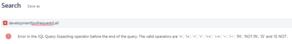

jira.pngBut when I try to use any of the options shown in the documentation, I get this:
What am I doing wrong? These kinds of searches would be really helpful to us.

Have you tried adding an operator at the end? Like development[pullrequests].all > 0
Esther Strom
May 17, 2019
Thank you! I saw that for specific numbers (i.e. greater than 2), but for some reason assumed that if I left off an operator, it would show me all.
