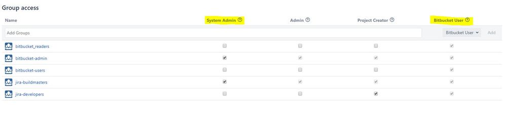

Login using that account and Click on the Administration Cog in the upper right hand corner of the screen:
Once int he Administration screen click on Global Permissions on the left hand pane.  Next you will want to update either the group or user access which will look something like this:
GlobalPermissions.JPGIn order to log in users will need to either be granted 'BitBucket User' by belonging to a group that has been granted that, or by being granted it explicitly in the User access list above the group access pane.
Since you are setting up Application Links you will probably want to give your user System Admin permissions or you should be setting up the link with an account that has System Admin permissions.
