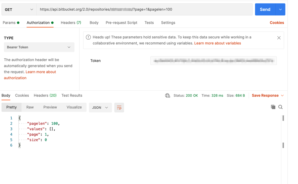

  • I then use the token generated in Postman to make a call to BB
Expected outcome

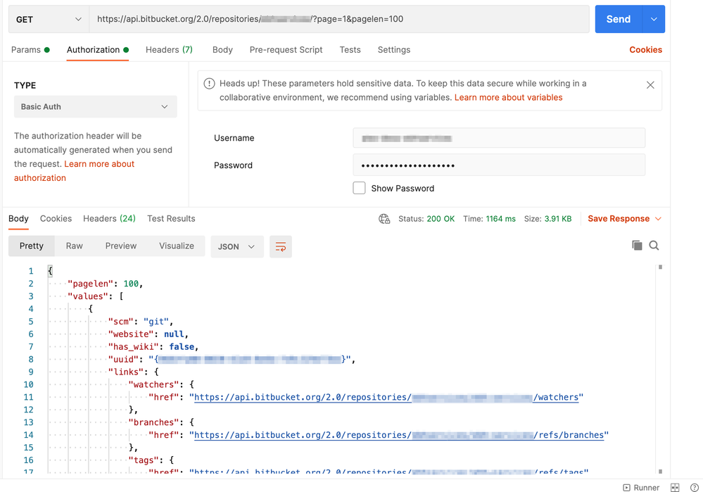

A list of repositories owned by the account, which is what I see when I make a call using Postman using basic auth and a BB app password:
Actual outcome
A 200 response but an empty values array:

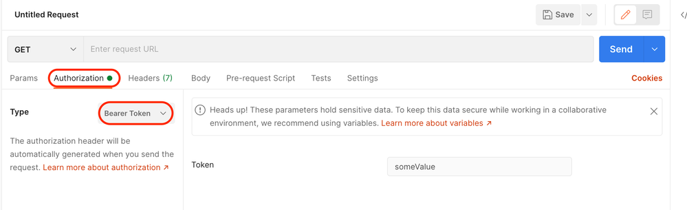

Worked it out. There were 2 problems:
  1. Despite what the docs say it appears as if you cannot submit the JWT token in the query string. It has to be in the header. I've informed BB support of this.

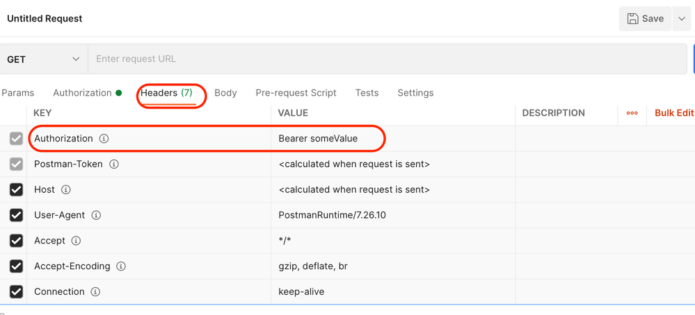

  2. When you select Authorisation type as "Bearer Token" in Postman:
1.pngthe "Authorization" header value is prefixed with "Bearer":
This needs to be "JWT".
After I made those 2 changes my GET request succeeded.

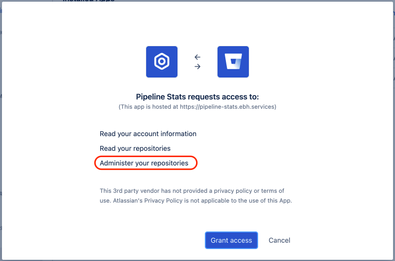

This was super helpful. I changed it to fetching a private repo as suggested and now I get a 404 - Access denied. You must have write or admin access.

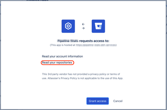

So it definitely looks like a permission error and not an authentication one. That is supported by this screen that is shown when the app is installed:
But this raises 2 questions:

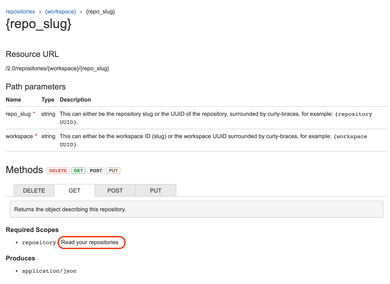

Tackling the 1st question first, I looked at the docs for GET request against a specific repo (see docs):
So I should not in fact need write or admin.
Turning to the 2nd question, I've read through Security overviewScopes for the Bitbucket Cloud REST API. I changed the app descriptor so that it now includes the scope "repository:admin". Now when the app is installed I see:
But I still get the same error when I make a call, 404 - Access denied. You must have write or admin access.

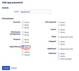

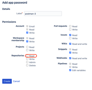

I tried one more thing. I performed 2 tests, both make calls via Postman using basic auth with an app password.
For the 1st call I used an app password with these permissions:
The call was successful.

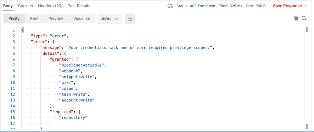

For the 2nd call I used an app password with these permissions:
This was the most permissive I could be, without granting read on repositories.
The call failed, as expected. But with this error message:
Note exactly sure what that means for my problem. But thought I would share incase someone smarter than I knows :)
