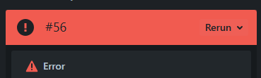

Thanks for your answer, Patrick! This is helpful, although I did know most of this. I'm not really getting far enough to troubleshoot most of that, however, because the pipeline isn't even getting started:
The text underneath reads "/Users/[username]/Desktop/MacOsRunner2/atlassian-bitbucket-pipelines-runner/bin/../temp/[runnerguid]/build". Importantly, that should NOT be the folder that runner is running in. It SHOULD be "/Users/[username]/Desktop/GitProjects/[projectname]/MacOsRunner/Runner1/atlassian-bitbucket-pipelines-runner/bin/../temp/[runnerguid]/build"
Sometimes, when it runs, that "MacOsRunner2" is a different number - generally 1 or no number there at all, simply "MacOsRunner".
Interestingly, the runner guid is correct - that's how I'm matching up the pipeline attempts with the actual correct folders on the mac. And at the same time, I do get runner logs on the mac, in the correct folder. Those logs consistently contain a "NoSuchFileException" like this one:
[2024-11-26 11:57:21,180] Setting up directories.
[2024-11-26 11:57:21,188] An error occurred whilst setting up directories.
java.nio.file.NoSuchFileException: /Users/[username]/Desktop/MacOsRunner/atlassian-bitbucket-pipelines-runner/bin/../temp/[runnerguid]/ssh
Some of them complain about an "artifact" folder, in place of that ssh folder. The fact that this is happening while setting up directories implies to me that the runner should be creating these folders. Even so, I've attempted manually creating them, and granting full rights to that path (despite the fact that the path is outside where I think it should be running to begin with), to no avail. The error persists. It truly feels like the runner is just doing something that I don't understand. And remember, to me, that runner is a black box. I can't see inside it or get details on what it's doing.
Remember, when it wrote that log, the runner itself was running in "/Users/[username]/Desktop/GitProjects/[projectname]/MacOsRunner/Runner1/atlassian-bitbucket-pipelines-runner/bin/../temp/[runnerguid]/build", and should be configured to use that folder as its "home".
One of those "shared environments" must be dictating the folder location somehow. I can't identify anything anywhere in my configuration or pipeline where I'm dictating that path, so it must be something the runner is coming up with. If I could get further, I could troubleshoot the shared environment situation. (Honestly, right now I don't think this pipeline writes to ANY shared folders, the intention is to keep each runner separate so that doesn't happen.)
I would appreciate any help figuring out how and why the runner is "choosing" the wrong path here.
