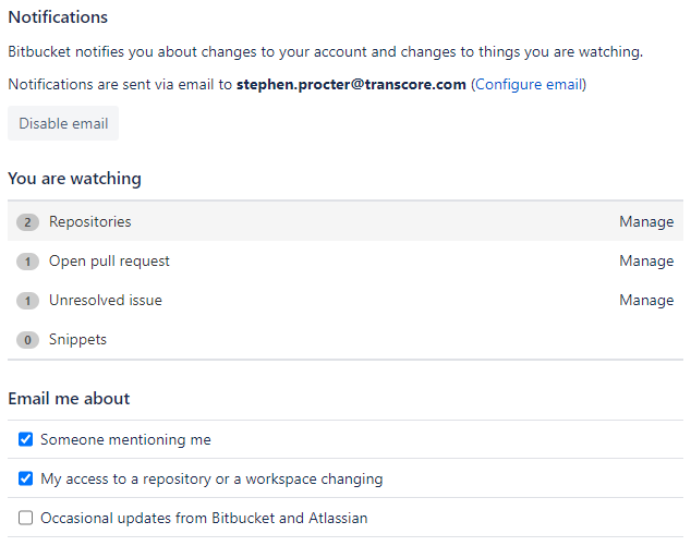

I'm assuming you have checked your notification settings and they seem correct: https://bitbucket.org/account/settings/notifications/

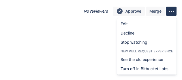

Additionally, on an individual pull request - are you listed as 'watching' the pull request?
Hi @Tyler T, yes notification settings look fine - only "Occasional updates" is unticked. I can confirm that I automatically get listed as 'watching' the new pull request (I have set myself as default reviewer for the repo), but do not receive any notification that the pull request has been created. Neither do I receive any notification when a comment is added to the pull request, even if I'm specifically tagged in the comment.

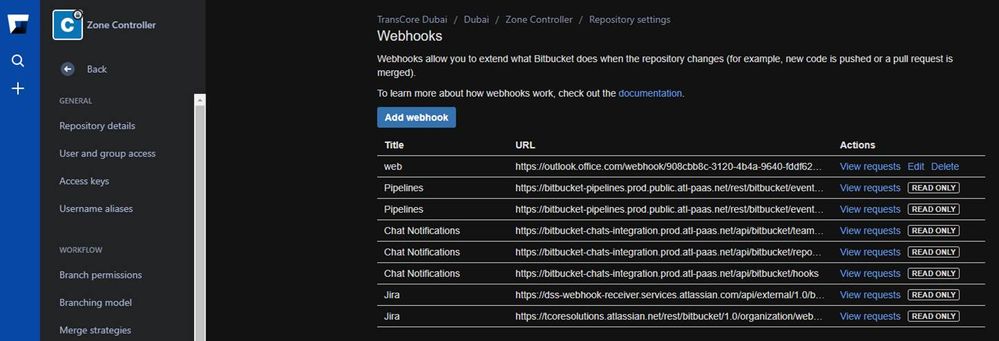

After further investigation, we've noticed that our newer repos have only 7 webhooks installed by default; 3 for Chat Notifications, 2 for Jira, and 2 for Pipelines:
In contrast, our older repos have 9 webhooks installed by default. The extra two are labelled "Bitbucket code search" and "Pull Request Commit Links":
Could this be relevant to my issue?
