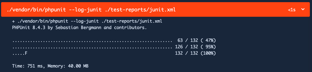

I have a pipeline that runs PHPUnit. One of the tests fail, and PHPUnit writes a test report:
The test report contains a record of the failure:

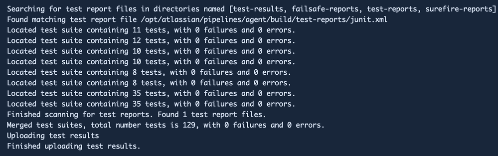

Yet Pipelines doesn't find the error:
The tests are consequently considered a success, which means the Tests tab isn't visible. The pipeline itself correctly fails because of the exit code from phpunit.
The expected result is that I should see the Tests tab, and within the tab I should see the failed test.

Thank you for your suggestion @Oleksandr Kyrdan. I tried this, but the result was the same as in my original post. The test report parser only finds 129 tests.

A clue might be in that the PHPUnit output in the first screenshot says 132 tests, while the total count in the last screenshot says 129 tests. So I guess that failure ins't found/recognized. But why?
