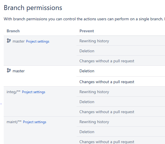

The branch permissions consists of these 3 options :
1)Rewriting history
2)Deletion
3)Changes without a pull request
Do I need to change any setting ?
Are any of those options set? The rewriting history setting could be affecting your force-push issue.
I deleted the 'Rewiritng History' option from the Branch permissions but It is also present in the Project settings .
And the user noted that the problem wasn't on master and this is needed for the Admins.
Yes, using the Prevent -> Rewriting history setting probably something you want to keep set on master. Your original issue was the the pull request didn't update in your feature branch.
