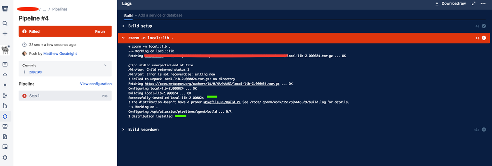

I am able to successfully install a fairly common Perl module according to cpanm but this somehow signals Pipelines that this script command had failed.  Anyone run into this or have any thoughts on why this would occur?  I am attaching a screenshot that shows a successful installation.  The only thing that I could think of is the failure to find the module in our private repo (I redacted my company's private CPAN mirror)  before trying other mirrors.  Even if this is the case, this doesn't seem like a case where Pipelines should fail the command/build.  The docker image I'm using is perl:5.24.  Going to continue and try out with a few other modules and see how that pans out and will update if necessary.  Thank you.
