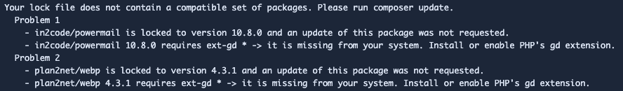

I am using deployer to deploy my TYPO3 project on the server. Since today I am getting this error: ERROR: Task deploy:vendors failed!
I changed absolutely nothing in my pipeline since the last time.
I get these informations:I already checked, the php extension gd ist active for my domain: https://derkreiger.at/20240430_info.php#module_gd
Can anyone help?
