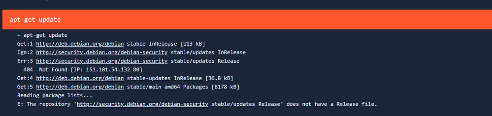

This has been a stable pipeline script that has worked for more than a couple of years. It just ftp's up the changes to the place we need them after they are pushed to bitbucket. You can google and find a very close example to it.
I have a hard time believing nobody else would be encountering such an error about the content at security.debian.org, so I'm wondering if the underlying linux that this runs under has an issue that Atlassian needs to address.

I believe this issue is related to the following discussion at Stack Overflow post:
This issue has been raised with the owner of the image - Failing to build pipelines? #2the owner of the issue mentioned that they are looking to fix it soon.
If the issue has not been fixed by the owner you can try the following alternate workaround such as:
  • Create your own custom image that you maintain yourself
  • Use another image
  • Use our default Docker image atlassian/default-image:2
Don't forget to follow the public discussion for a further update since this is an issue with the external docker image.
I hope this helps.

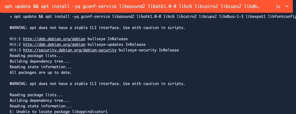

Got an similar issue since yesterday
