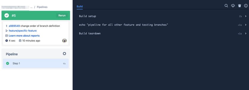

I may have found a bug in the pipelines definition.
In my project, a specific build should run for the `feature/specific-feature` Branch, all other feature and testing branches should have the same steps. After reading the documentation (https://support.atlassian.com/bitbucket-cloud/docs/use-glob-patterns-on-the-pipelines-yaml-file/), I created a separate branch pipeline for this specific branch. But when pushing to this branch, the other pipeline runs.
I tried this with an example project and a very small bitbucket-pipelines.yml:
image: atlassian/default-image:2
pipelines:
default:
- step:
script:
- echo "default pipeline"
branches:
feature/specific-feature:
- step:
script:
- echo "specific feature pipeline"
'{feature/*,testing/*}':
- step:
script:
- echo "pipeline for all other feature and testing branches"
But, when pushing to the `feature/specific-feature` branch, the pipeline outputs "pipeline for all other feature and testing branches". I have attached a screenshot of the pipeline output:campaigningbureau___branch-test___Pipelines_—_Bitbucket.jpg
Could anyone help me?

Hi @schind ,
I believe this may be a bug, as a pipeline for a specific branch should override a more generic expression that would match this branch.
I am going to reach out to the development team to confirm and will then raise a bug report.
Based on several attempts I made to reproduce and narrow down the scope of the issue, it looks that the problem is introduced when the curly brackets are used.
As a workaround, I would suggest using a yaml file like this instead:

schind
January 13, 2021
Hi @Theodora Boudale ,
thanks for your response. Yes, it seems to be an issue with the curly brackets. I can confirm, that the workaround does work for me.
