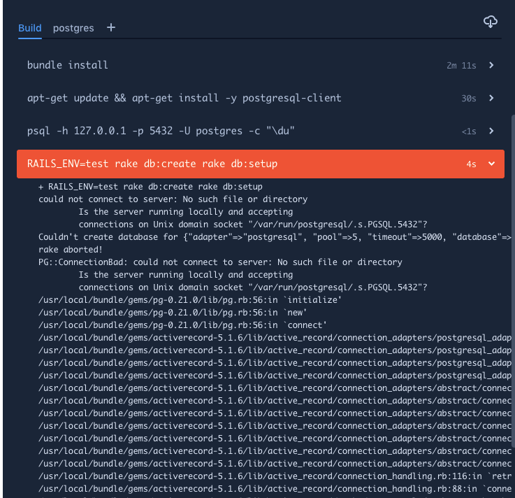

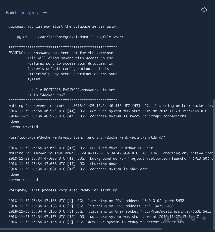

I have same issue. here are images. Postgres service is avialable but can't establish connction.

Screen Shot 2018-11-29 at 9.11.39 PM.pngScreen Shot 2018-11-29 at 9.12.43 PM.png
