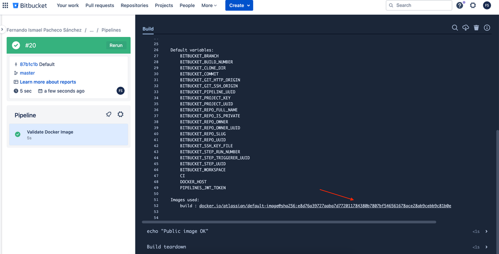

The result with this public image is OK, and has the same code SHA

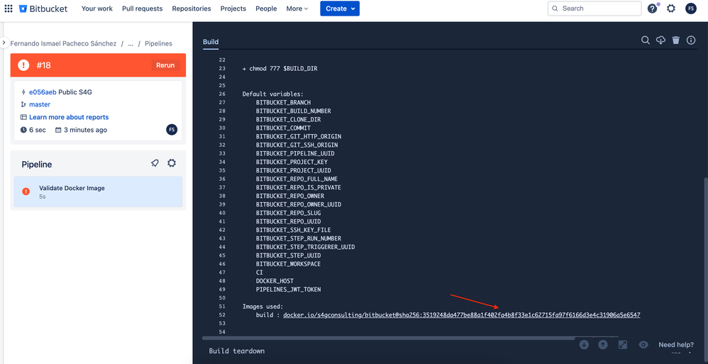

The public image was pulled (code SHA is right), but the result is ERR:
If the public images are pulled for each pipeline:
  • Why the second pipeline fails?
  • Why the second pipeline cannot run: echo "Public image OK"?

The reason why your Pipelines build is failing while using the custom Docker image (s4gconsulting/bitbucket:latest) is that it was built using linux/arm64 architecture.
For comparison, you can check the following links and notice the "OS/ARCH" field:
Unfortunately, we do not officially support ARM images on Bitbucket Cloud Pipelines infrastructure at the moment.
We do have an existing feature request for it that can be located through this link. - https://jira.atlassian.com/browse/BCLOUD-15317
You can upvote and watch it for now so that you'll be notified of any updates from our team when the feature becomes available on Bitbucket Cloud.
For now, you can rebuild your custom Docker image and use linux/amd64 architecture instead.
