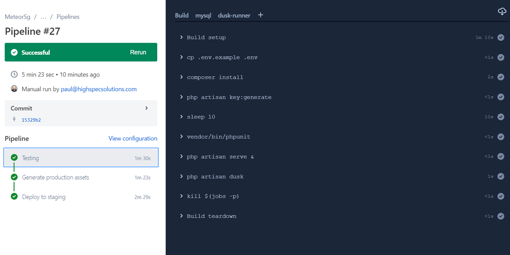

I've been playing around with pipelines and have managed to get my pipeline working exactly the way I want. However it takes 5 minutes to run and looking back through the logs most of this is due to the Build Setup portion of each step.
My pipeline has 3 steps and the Build Setup takes between 30s and 90s on each step.
I was using a private docker image but have changed this to be a public image as I understand these are cached however this hasn't affected performance. The image is large (650MB). The repo is about 25mb.
Any ideas of what I can change to improve / diagnose the performance issues?

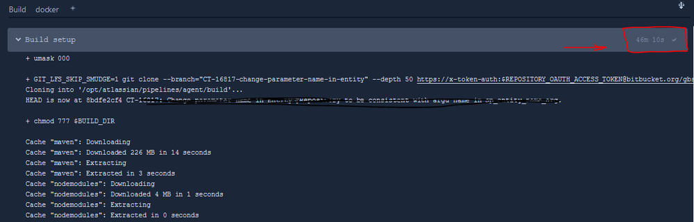

We have the same issue. Pipeline's build setup speed varies from 30 seconds to 50 minutes!
This is the output of the build setup and unfortunately there is no timing being printed out in details except the time took for downloading caches. However, the whole step took 46 minutes:
+ umask 000+ GIT_LFS_SKIP_SMUDGE=1 git clone --branch="CT-123-change-parameter-name-in-entity" --depth 50 https://x-token-auth:$REPOSITORY_OAUTH_ACCESS_TOKEN@bitbucket.org/abcd/abcd.git $BUILD_DIR ; git reset --hard 8bdfe2cf4dd33902b321208d92a90f8f236d3660 ; git remote set-url origin git@bitbucket.org:abcd/abcd.gitCloning into '/opt/atlassian/pipelines/agent/build'...HEAD is now at 8bdfe2cf4 CT-123: issue description+ chmod 777 $BUILD_DIRCache "maven": DownloadingCache "maven": Downloaded 226 MB in 14 secondsCache "maven": ExtractingCache "maven": Extracted in 3 secondsCache "nodemodules": DownloadingCache "nodemodules": Downloaded 4 MB in 1 secondsCache "nodemodules": ExtractingCache "nodemodules": Extracted in 0 seconds
this not only costs us but also delays the development team. Any idea?
