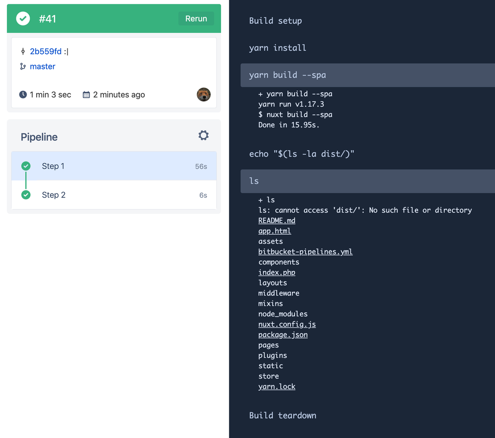

I'm trying to use Bitbucket Pipelines to deploy my Nuxt.js based web app. Below there is my bitbucket pipelines config:
image: node
pipelines
custom:
init:
- step:
caches:
- node
script:
- yarn install
- yarn build --spa
- echo "$(ls -la dist/)"
ls
- step:
script:
- ls
And It is simplest as possible. It's installing all dependencies (yarn install) and using nuxt command yarn build --spa.
Yarn build --spa command is creating new dist folder and putting there build files. If dist folder were already existing script removes that folder and creates new dist folder. If I run this commands on my local machine I'm getting new dist folder filled with build files.
Whole steps are working fine, build step also, but finally there isn't any dist folder.
Most related topic on the internet that I've found is that: https://github.com/nuxt/nuxt.js/issues/5344 – but is more about docker image than bitbucket pipeline. Is there anything that I can fix in my config without creating new docker image?
4 answers

Deleted user August 30, 2019 edited
I got the same problem. Got a nuxt app and the build steps are similar, just doing it with npm ;)
Already added the artifacts and validate the .yml file. But the pipeline fails because no dist folder is created after build step and not shown at this console output:
- l
Any suggestion why dist/ is not created at build step in the pipeline? Locally everything works.
Screenshot after output of ls -la:

dynamiteReady November 18, 2019 edited
I'm also using Nuxt. I've been through the same steps. I'm trying to add an artefact, but the `dist` folder is never generated. Like the post above, the `ls -lsa' command shows that no `dist` directory was ever created at the end of the build process.
There's no error in the logs (even with `npm --verbose`), and the entire pipeline completes with an indication of success.
Is this not a bug?
Given @daffodilistic post, it sounds like it could possibly be a RAM issue, but without an error message, it's going to be extremely difficult to recreate that bug, especially on free accounts.
