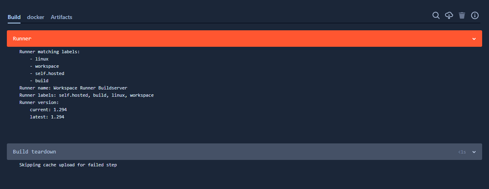

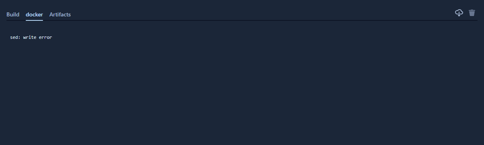

I try to run the following pipeline:
This will cause the errors on bitbucket pipelines (docker: sed: write error). I dont know where this error comes from. It will work when i run this configuration on the bitbucket servers, by removing the runs-on keyword and variables. This will also deploy the right version to beanstalk.
Where does this error come from and how can i fix this?

[Edit] Other pipelines which dont need a pipe will run successful without problems

Fabian February 25, 2022
Hi @David Bergevoet ,
is your runners host debian 11?
I had the same error and this workaround fixed it for me: https://jira.atlassian.com/browse/BCLOUD-21693
Best regards
Fabian
Like David Bergevoet likes this
David Bergevoet February 25, 2022
Hi @Fabian
Yes the runner indeed hosts debian 11. I'll try your workaround and will check if it works for me, probably next monday.
Thank you for suggesting a workaround and have a good weekend!

David Bergevoet March 6, 2022
Hi @Norbert Csupka  & @Fabian
This workaround works for me! Sorry for responding this late, but there were some things with more priority then this issue. Thank you both for responding and helping me out.
