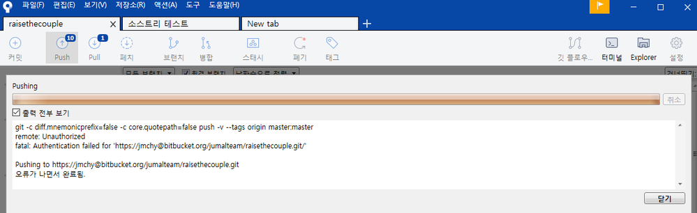

I use bitbucket
pull is fine but not push
push -> write password -> error
Bitbucket Homepage ID and password when pushing?
Is there another password? Or I do not know what went wrong.

Hi Choi Dae Yun,
From your screenshot, your remote URL is not evident.
Does your remote URL have the username as part of it i.e. https://USER@bitbucket-url
where USER is a valid Bitbucket user.
If so, please check if your repository has "Allow users without a Bitbucket account to clone and browse this repository." flag enabled on Repository Permissions page (Choose repository -> Gear icon on left -> Repository permissions) then git pull will work without authentication.
However, git push will still require authentication using a valid password for USER specified in the remote URL.
Hope this helps.
Kanwar | Atlassian
Choi Dae Yun March 28, 2018
캡처.PNG 캡처2.PNG Does USER mean Username??
My Username is jmchy
Push the first photo and the second photo after login
first photo id, password is Atlassian homepage id, password

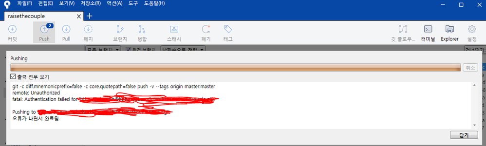

Choi Dae Yun April 9, 2018
캡처.PNG 캡처2.PNG Is the first picture the answer to your question (Attach the output)?
sourcetree -> option, it is a picture of the account authentication, and authentication succeeds.
If you press push in that state, Bitbucket login window appears and you get the same error.
