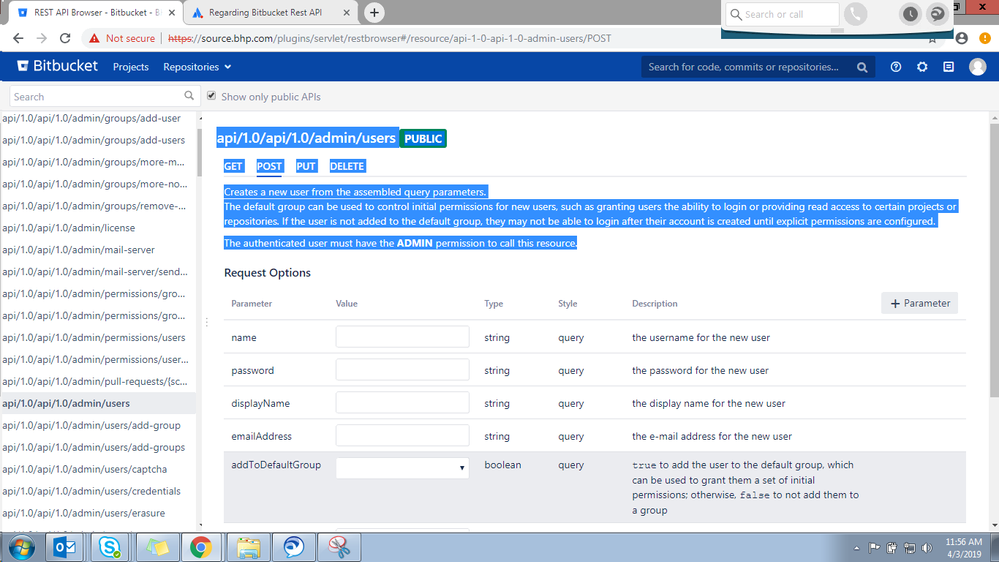

Getting the below error when ever am posting any content on rest API.
The same error comes when i post using curl too.
Need your urgent help in resolving this.

Hi Rafael,
https://source.bhp.com/rest/api/1.0/api/1.0/admin/users?
This URL which is coming from the REST API BROWSER. Even if am using CURL for posting the content on https://source.bhp.com/rest/api/1.0/admin/users? (its giving me the same error.
In every URL api/1.0/api/1.0 is repeating.
Could you please help.

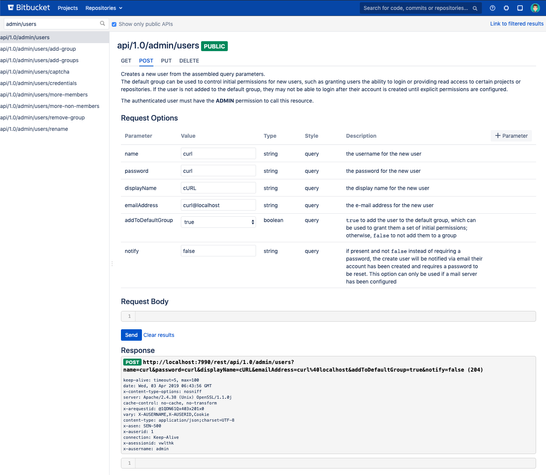

Hi @lovisharma ,
What is the Bitbucket Server version and REST API Browser add-on you are running?
The /api/1.0 duplicate might be caused by a redirect on your web proxy, incompatible plugin or something else. As you can see not only from https://docs.atlassian.com/bitbucket-server/rest/5.16.0/bitbucket-rest.html but also from screenshot below the duplicate seems to happen only on your environment.
The following cURL command should create a user "curl" in your Bitbucket instance:
# replace {USERNAME}, with user that can create users in Bitbucket
# you will be prompted to type in user's password
curl -k -v -u {USERNAME} \
-H 'Content-type: application/json' \
-H 'Accept: application/json' \
-X POST 'https://source.bhp.com/rest/api/1.0/admin/users?name=curl&password=curl&displayName=cURL&emailAddress=curl%40localhost&addToDefaultGroup=true¬ify=false'
Could you please run the cURL command from above and share the output, if any?
