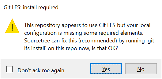

Now, when I go to clone the repo, I get this message:

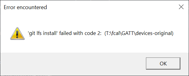

and when I click Yes, I get:
image.png So I open a terminal window and enter git lfs install manually and the hooks are added.
That being said, I think this is resolved.
