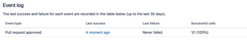

I quickly tested Bitbucket Data Center version 8.19.7's native "Pull request - approved" webhook event, and it triggered successfully (screenshot attached).
This issue can be coming from a configuration setting or plugin in your Bitbucket setup. The <Bitbucket-Home-Directory>/log/atlassian-bitbucket.log file may include more information about this error; however, if no evident errors are found, please raise a ticket with Atlassian support to check the underlying cause of the issue.
