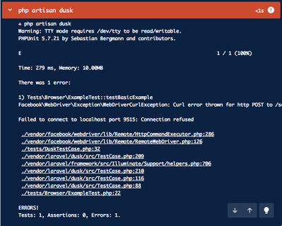

I am trying to setup a Laravel 5.4 project in BitBucket Pipelines, with Laravel Dusk test scripts. However, I can't seem to get a successful build. After fixing several issues and finally getting my build to run my test scripts, I am not stuck at :
How do I get the Chrome Wed Driver to launch and run the test?
