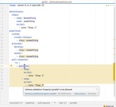

Hi @Claudenir Machado , welcome to the Atlassian Community.
The bitbucket-pipelines.yaml online validation (the online tool in your screenshot) does not always show the whole picture.
In your case the configuration error message is mandatory highlighting the error.
The error is not a big one, the `name:` property needs to be indented once more into the `step:` property turning it into an actual object (instead being null).
That is meant by the error message that the step section is empty (it actually is).
Same is for `script:` in your following YAML. Just indent this all once more what belongs into `step:` and it should work.

If you're using and editor or IDE to edit the files, check for JSON Schema support, despite the file is YAML, JSON Schemas also apply to it (YAML has a JSON representation). Editors / IDEs normally highlight then the erroneous places more visually so errors are easier to catch.
bitbucket-pipelines.yml validation inside IntelliJ based IDE (here Phpstorm), works with JSON schema validation via https://www.schemastore.org/json/ .
