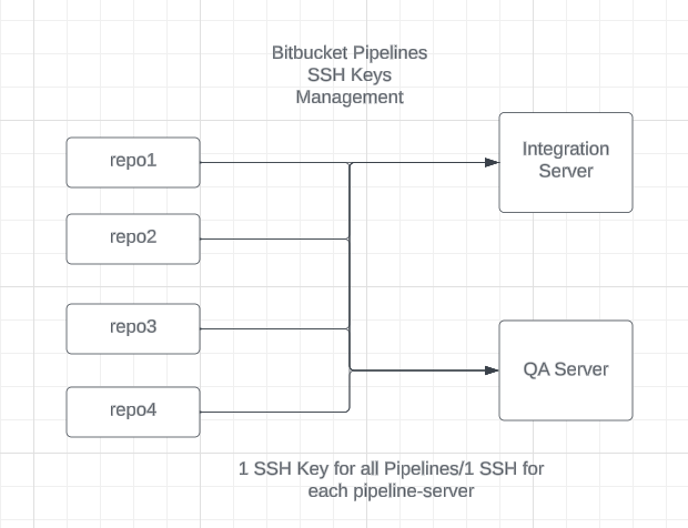

I'm working with the Bitbucket Pipelines
In the deployment step, I'm connecting to two servers (Integration/QA) to execute this step using an SSH key.
What is the best practice regarding SSH Key Management
1 SSH key per repo-server.
1 SSH key ("MASTER") for all repos-servers?

Using one SSH key for all repos-servers may be easier to set up. However, if the key is compromised (e.g. someone leaks it intentionally or unintentionally), a bad actor may get access to both servers. You would then need to replace the SSH key in all repos and all servers.
You could use one key per server for all repos (so two SSH key pairs in total). If a key becomes compromised, a bad actor may get access to one server only and you would need to replace it in all four repos and in the server where it belonged.
Using one key per repo-server (eight SSH key pairs) is a bit more work. If a key becomes compromised, a bad actor may get access to only one server. The key would need to be replaced in one repo and one server.
The second and third options may be best to minimize the impact of a potential leak.
