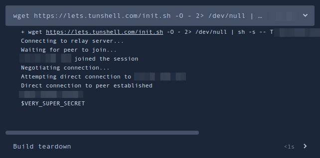

~ # printenv | grep SECRET
SUPER_SECRET=very, very secret
VERY_SUPER_SECRET=very, very secret (and secured) # this one is a secure variable
~ # echo "very, very secret (and secured)" >> /proc/33/fd/1 # pipeline log: $VERY_SUPER_SECRET
~ # exit
[2021-02-12T01:10:12Z ERROR client] Error occurred: Broken pipe (os error 32)
Pipeline image used in this example: ktomk/pipelines:busybox
Output in log
