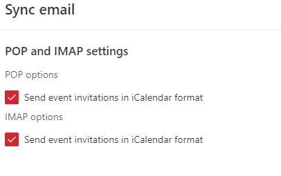

Outlook office 365 settings in my account

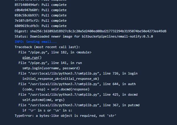

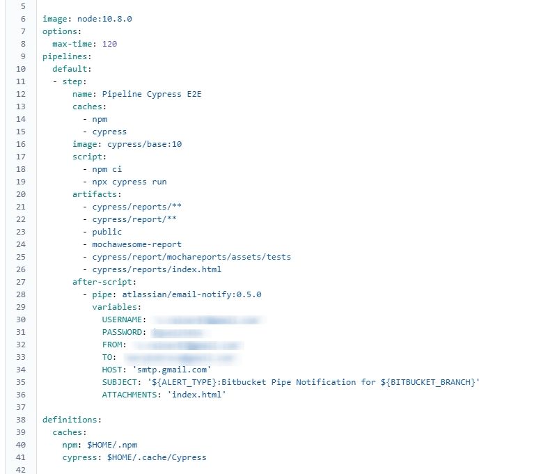

Hi! Have same issue on my Pipelines in BitBucket.
Here is my ymlFile. Sending from gmail account to gmail account. When try to add Port - it fails telling that there is no way to send an email
And this is what I receive in the end
If anyone can help me with that I would be very appreciated! Happy holidays!
