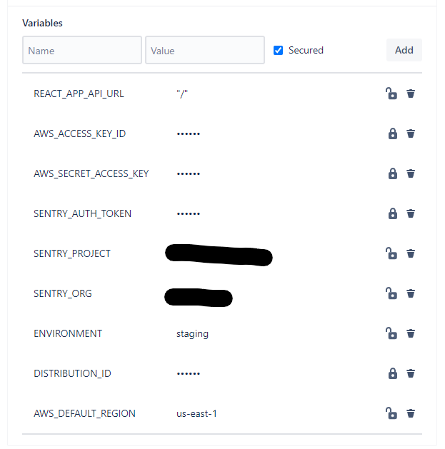

×I set up all variables required but i receive this error
ERROR: Error creating a cloudfront invalidation
✖ Failed to create a cloudfront invalidation: Unable to locate credentials
I set up, AWS_SECRET_KEY, AWS_ACCESS_KEY_ID, DISTRIBUTION_ID and REGION, and received credential error

We need more information. Please, provide us your config details, and a screenshot of your repository variables (values should be hidden).

The S3 deploy steps works fine, and use the same variables as the cloudfront

@Felipe Micheletto Try to delete/add_again DISTRIBUTION_ID in the repository variables. Check in the logs this line:

I Found my problem, i was using deployment variables were is not set to use, i added my variables as repository variables and everything works now! Thanks @Igor Stoyanov
