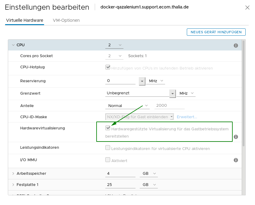

Hi Malcom,
actually this is quite easy, since there is a Flag, which can be used to update the CPU settings within VMWARE.
Hope it helps.
