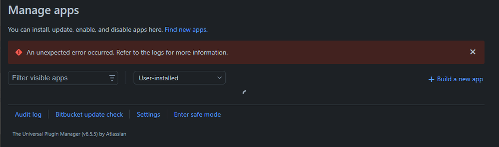

I recently migrated from BitBucket 7.2.5 running on MySQL to BitBucket 8.19.3 running on PostgreSQL. When I navigate to the Manage apps screen from the administrative section, I get the following after a few seconds of loading:

It looks like it's trying and failing to make a GET request to /rest/plugins/1.0/installed-marketplace. If I try to hit this URL in my browser, I get an HTTP 504 gateway timeout.
Some more relevant info:
  • I have no JARs in my $SHARED_HOME/plugins/installed-plugins dir
  • I have tried entering safe mode
  • I have deleted $LOCAL_HOME/plugins/.osgi-cache and restarted Bitbucket
  • No rate limiting is enabled
  • The Bitbucket base URL setting is correct
  • We are not using a proxy

For anyone reading this, the entire issue was because our database and shared home NFS were in a different data center from the Bitbucket app. The performance in the application was terrible, and ultimately this error was caused by a gateway timeout.
Moving our database and shared home into the same data center as the app resolved the performance issues and fixed this UPM issue.
