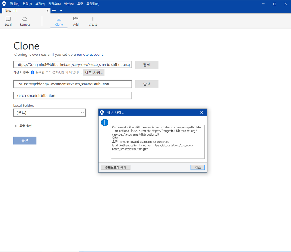

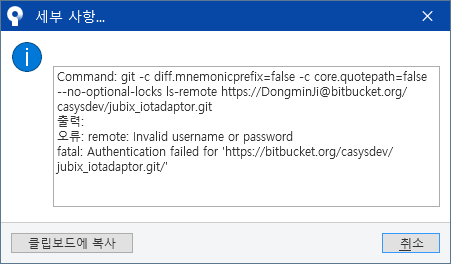

And I reinstalled Sourcetree and try Clone.
But I dose not made a Clone.
Please check my error description. and should you give me a solution?

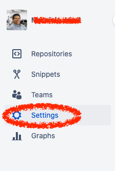

Of course, you need to navigate to your profile icon (lower corner left)
and select view profile, after that you will this menu

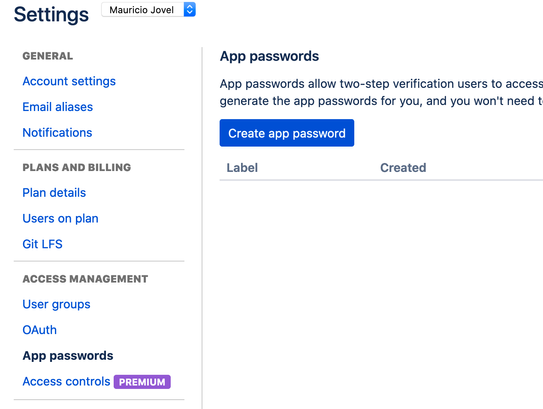

select settings and after that select app password
And create one, select all the options that you think you will need.
The direct link should be this:
https://bitbucket.org/account/user/{your_username}
but you need to change the {your_username} with your username.

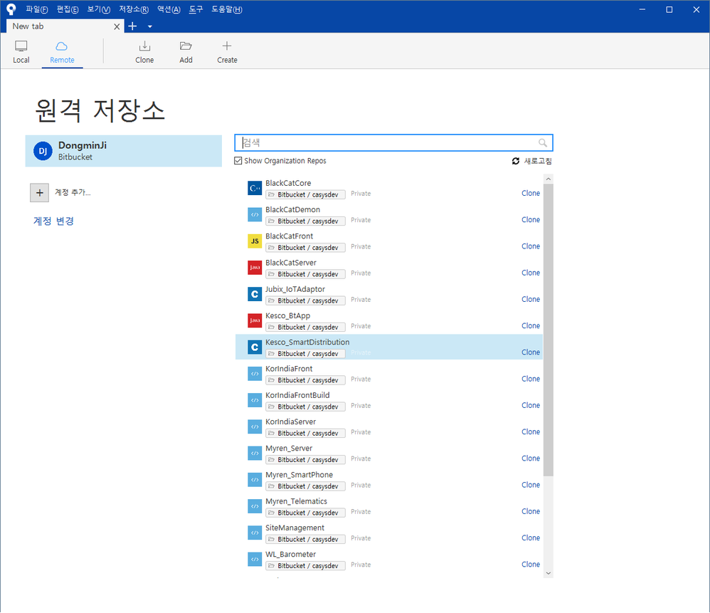

I made an App passwords, but I got the same problem.
I can log in and see the repository using Sourcetree, but I can't make a clone.
I dont understand it.
How can I fix it?

Hello @[deleted] ,
Welcome to the Community.
The error hints that you configured incorrect credentials. Username looks right, so it must be the wrong password you used.
