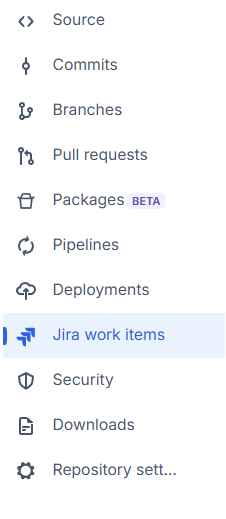

    After an integration, on the left side panel will show an item called Jira work items. It looks like this:

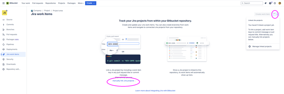

In the center or top right, add a manual link project from the drop down, after that, the issue tracking shows back up. You just follow the steps of selecting the Jira project to it and he issue tracking returns. You just need to remember to add the TODO in your source code to easily link it with the Jira bug, feature, or task.
It took me an hour, but with these directions, it could be done in 10 to 30 minutes.
