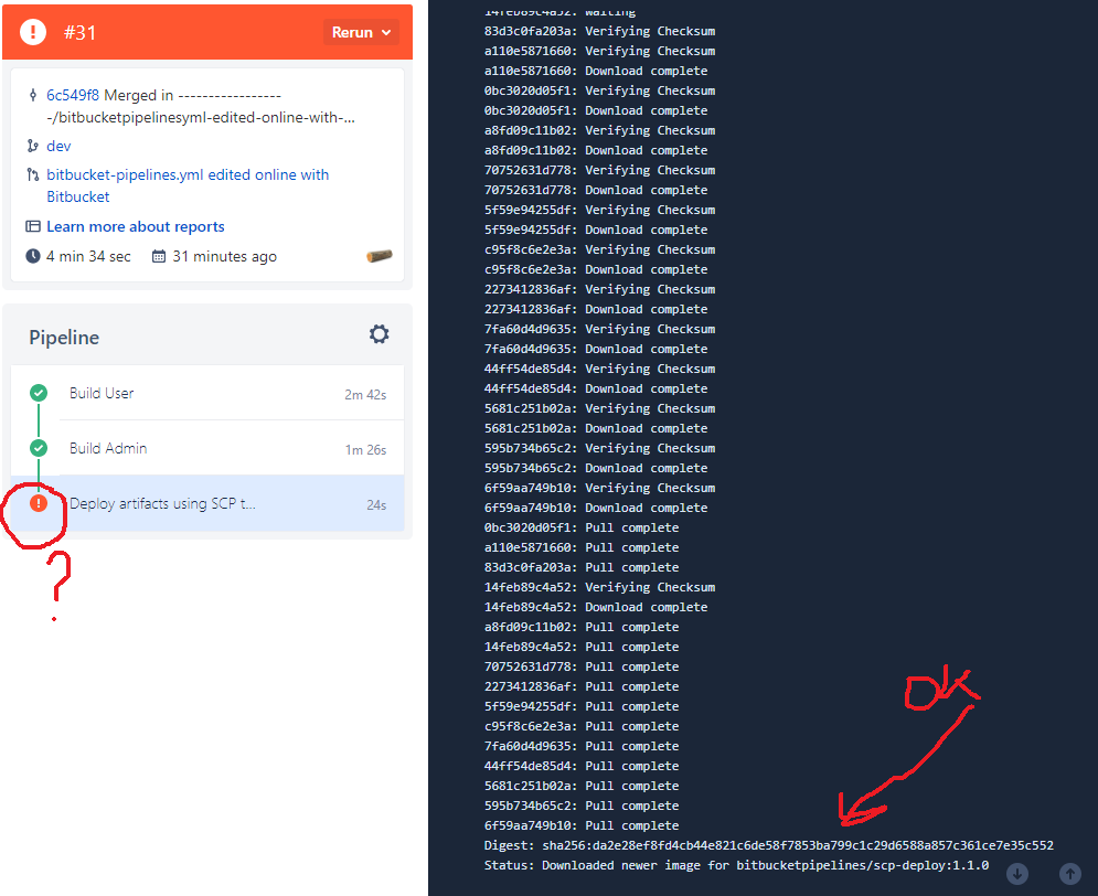

in pipelines i have following script:
 - step:
name: Deploy artifacts using SCP to STAGE
deployment: staging
script:
- pipe: atlassian/scp-deploy:1.1.0
variables:
USER: bitbucket
SERVER: x.x.x.x
REMOTE_PATH: '<my path>'
LOCAL_PATH: '<local path>'
i have atlassian/scp-deploy:1.1.0 downloaded properly, but BB thinks it's not OK and stops pipeline.
bb tech.pngWhat should i do
 to make it work?

Hi @Алекс Барзински and welcome to the community.
Could you please add DEBUG: 'true' in the pipe variables, as follows:
variables:
USER: bitbucket
SERVER: x.x.x.x
DEBUG: 'true'
and then copy-paste here the full output of the pipe (after you remove any sensitive/private info from the output), so we can have a look?
