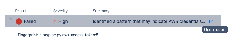

The pipeline finds and annotates the two findings (amongst others) in a report, see the two findings expanded below, however, the file URL points to the wrong commit (see bottom-left in attached screenshot)
As-is behavior:
- file links to current commit. The linked line of code is completely out of date. See below example, pointing to and highlighting (in yellow) an empty line of code.
Expected behavior:
- Preferably the file URL links to the correct line of code in the correct commit.
- If not possible, remove the fie URL and clearly add commit hash in the report, so user can find it themselves.
Unfortunately, this is a pretty serious issue, because in practice many leaks are not found in the latest commit and the findings are confusing to users.

Hi @Casper Rademaker . New version of the pipe with correct links available.
Example:
```The pipeline does not seem to find any leaked secrets when triggered manually, rather than from a pull request.```  -- could not reproduce this.
Regards, Igor
Casper Rademaker February 14, 2025 edited
Hi Igor,
This is great work, thanks, I was able to confirm that the findings in the secret scan pipeline reports for 3.1.0 link to the right commits. Super happy with this!
