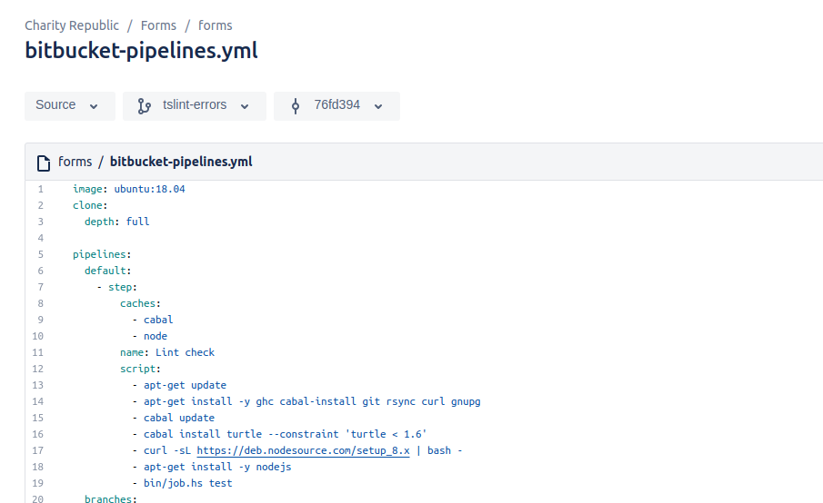

liamcmcdermott September 18, 2018
I tried adding a clone depth of full, but still got the same error. Presumably this only gets all commits for the current branch?
My `bitbucket-pipelines.yml`:

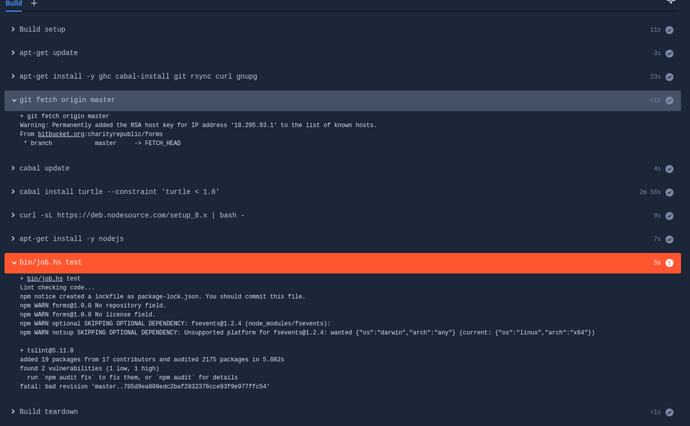

liamcmcdermott September 19, 2018
Tried adding `git fetch origin master` to the script part of the pipeline (clone depth is also set to full) and got the same error message. The git fetch seems to work fine, so I'm confused.
That commit should be available too, since it's the commit that triggered the pipeline.
