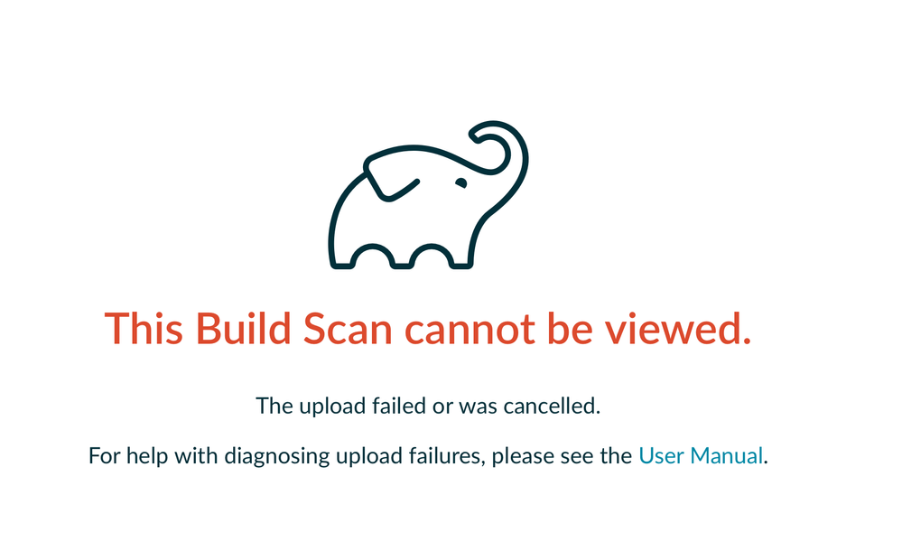

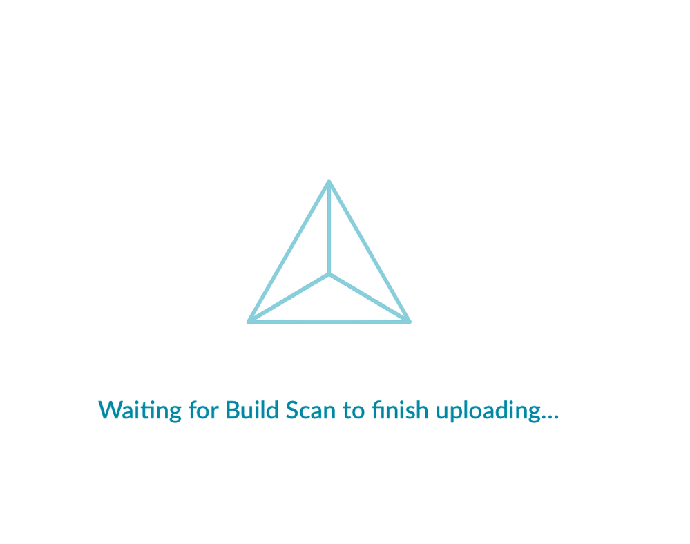

we are running gradle tasks with the --scan parameter in our pipelines but most of the time they cannot be views afterwardsScreenshot 2023-04-14 at 16.25.18.png Screenshot 2023-04-15 at 22.46.19.png
what could be the reason?

the images are from the gradle server where I want to view the results of the build scan

but when I click I get the errors shown above
