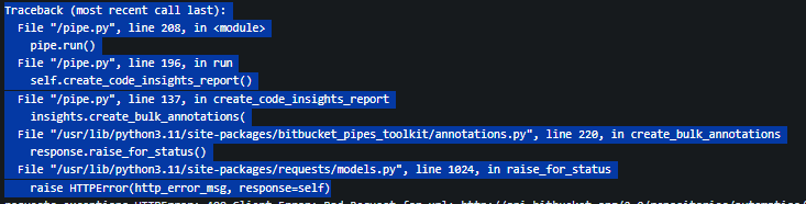

Hi Igor,
im using this owasp dependency check pipe
