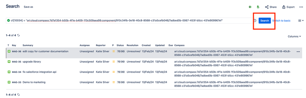

4.  Type = and then type or paste in the name of your component. You will see a list of matching options appear below the query line. Select the correct component. You will see the ARI of the selected component auto-populate in the query bar.
5. Click "Search".
This is what the search bar looks like after you select a component in Step 4.

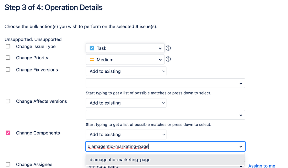

9. Scroll down to the Components field, and search for same component you searched for earlier.
10. Click the drop down and select “Add to Existing.” (If you use “Replace all with” instead of “Add to existing,” you will erase any historical component data you have, which you may not want to do.)
11. Click “Next” at the bottom of the screen, and then click “Confirm” once you review your changes. Your issues will now be updated. :check:
This is the bottom of the "Step 3 of 4: Operation Details" page.
