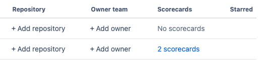

You're correct regarding the actions that you can execute in bulk for components using the current Compass UI - although there are shortcuts that would allow you to perform some of those modifications inline in your search results, like adding an owner team, or starring the component of that row in a single click (hover over starred and you'll see the star toggle for components that aren't part of your favorites yet).
