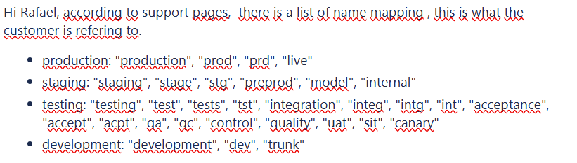

Our development environment is called "Entwicklung," and Compass expects "Development" or "Dev" as the name. Can a mapping be created here?

Hi there, can you tell me where they are seeing this requirement for "Development" or "Dev" on the name?
AFAIK environment is not a default compass attribute, ref https://developer.atlassian.com/cloud/compass/config-as-code/structure-and-contents-of-a-compass-yml-file/
Blum, Volker (Extern) May 9, 2025

Any chance the customer can send us the link to the support page?
Blum, Volker (Extern) May 14, 2025
Hi Rafael, this is the link:
https://support.atlassian.com/compass/docs/integrate-compass-with-github/#GitHub-environment-name-mapping
And Atlassian Support already confirmed, that there is no way to change this.

Enrique Serrano Valle
May 16, 2025
@Blum, Volker (Extern) I believe you're correct. I understand the integration wouldn't be as direct, but you could always use the Compass API (REST or GraphQL) to orchestrate sending the events. With a tier in there, you can remap the environment before propagating it to Compass.
There's some more documentation about this here: https://developer.atlassian.com/cloud/compass/components/send-events-using-rest-api/
And here's an example of how to orchestrate sending events from a CI/CD pipeline: https://developer.atlassian.com/cloud/compass/components/send-events-from-bamboo/
