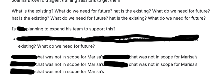

Content duplication is when either an entire page, or a subset of content on a page unexpectedly appears twice in the Confluence editor whilst collaborative editing is enabled. This duplication is most apparent when a page is published and the content appears longer than the user expected. Content duplication can also occur more subtly with only small subsections of content duplicated. This unintended duplication is frustrating to users as it requires manual intervention to correct, or perhaps worse, may not be noticed at all.
Content duplication is a symptom of several underlying problems with collaborative editing. When the collaborative editor encounters a scenario it is unsure of how to handle, it will keep both versions of the content in order to allow the user to recover the content they want to keep. There are multiple scenarios where we provide the collaborative editor with conflicting information, and it falls back to this safety mechanism, to preserve all the content.
The challenge has been that each of these issues has been incredibly complex to investigate due to limited visibility of data involved in the issue, and that the behaviour of each of the issues appears identically to an end user. We understand this may have given our users the impression that fixes have been slow and still haven’t worked, and that Atlassian isn’t treating the issue as a priority. Behind the scenes, the various tickets are being regularly reviewed and work is continuing on fixing the various causes of the behaviour being experienced by users. Throughout the process of investigating and fixing these issues, we’ve received dozens of Collaborative Editing Feedback Tool reports (more on this below) to review. We really appreciate the assistance from the customers who have contributed to this investigation as it has led to the identification of the issues below.
