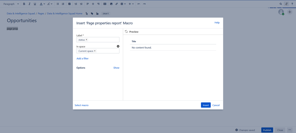

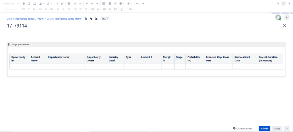

If you could please help me. I can't get the dashboard page to show the columns statuses. I have followed the instructions to the dot and still not working. Could you please let me know if you have encountered this issue and how to resolve it? I have tried no spaces after commas not spaces between words and nothing has worked for me.  Please kindly help me.
Many thanks!
Here is one of the project reports
