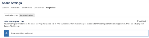

Integrate the space with the project
After installing the HTML macro, make sure to add the Jira project through the following steps:
  1. Go to the space where the page is located and tap Space Settings in the sidebar
  2. Select Integrations
  3. If no integration is added, tap the Add link button and select your Jira application
  4. Select the project and tap Create
