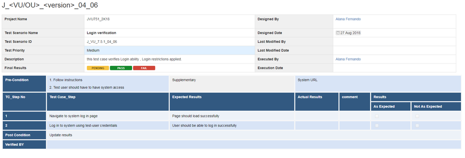

Inside single test case page, there are two tables. The first table contain general information about the test case. And that table is included inside a page property macro to use some information in summary results pages.
The other table contains test steps and results. Also you may noticed results section has 2 separate columns; by adding check boxes (tasks) it is easier for testers to mark step results. So that testers have to edit the page only once just to enter final results for the test case.

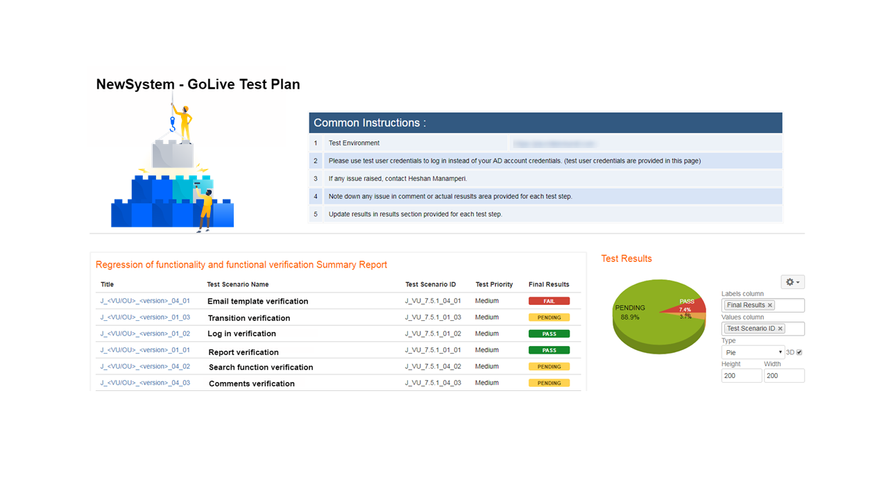

Summary and final test results
As same as Assignee summary page; summary page (parent page of entire test plan) contains results summary which generates information through page property reports macro. To get a quick overview a chart macro is included there. Best thing about this is that testers do not need to spend time after testing to collect results and generate reports; the report generates automatically every time a tester updates test results for a single test case.

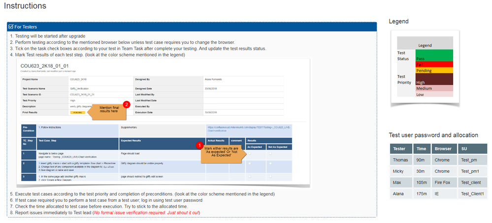

Also an instructions page for testers are included inside the test plan page tree. I usually takes help from my other team mates who are not Testers. It is easier this way to provide instructions in a page so that they don’t want to chase me to ask how to use this test plan 😊
