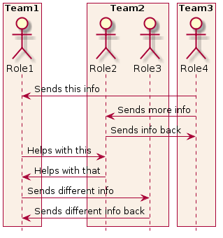

Sequence diagram: Roles and relationships
PowerPoint can be useful as a thinking tool but sometimes results in messy slides with many arrows as people think things through. This sequence diagram shows the same information exchanges as the slide but is much tidier.
One advantage of diagrams is that they can be edited in-page instead of having to edit a PowerPoint presentation, export slides as static images and then insert them into a wiki page.
@startuml
hide footbox
box "Team1" #linen
actor Role1
end box
box "Team2" #linen
actor Role2
actor Role3
end box
box "Team3" #linen
actor Role4
end box
Role4 -> Role1 : Sends this info
Role4 -> Role2 : Sends more info
Role2 -> Role4 : Sends info back
Role1 -> Role2 : Helps with this
Role2 -> Role1 : Helps with that
Role1 -> Role3 : Sends different info
Role3 -> Role1 : Sends different info back
@enduml

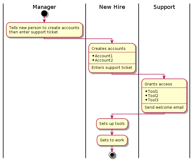

Activity diagram: Onboarding process
A team’s onboarding process needed review. The manager was surprised when I fired up Visual Studio Code during our discussion but the rigor enforced by a UML diagram had immediate benefits. Using an activity diagram with swimlanes required us to a) put the steps in sequential order and b) clarify who did what. It’s now more obvious that account creation happens before access is granted, which had been confusing before. In the actual diagram each step has a link to the instructions for doing it.
Everyone who sees this diagram “gets it” immediately and having a clear path to follow has made onboarding much smoother.
image-20200508-233239.png@startuml
|Manager|
start
:Tells new person to create accounts
then enter support ticket;
|New Hire|
:Creates accounts
* Account1
* Account2
Enters support ticket;
|Support|
:Grants access
* Tool1
* Tool2
* Tool3
Send welcome email;
|New Hire|
:Sets up tools;
:Gets to work;
stop
@enduml
