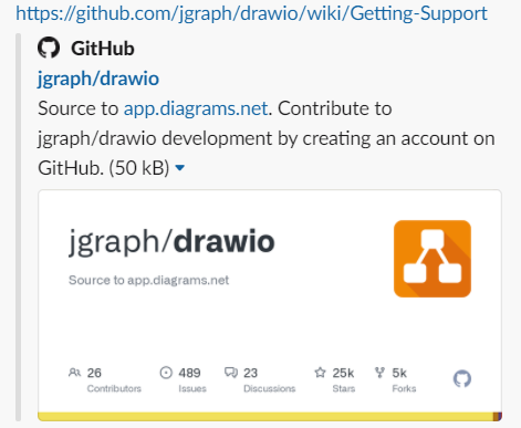

松本優子 July 12, 2021
License Error
Your license is not valid, please see this page
Close
The link on the page will take you to a github page with support information.
