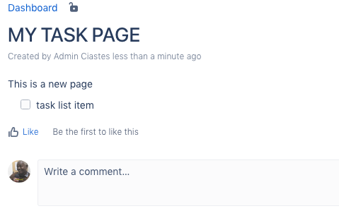

This is the resulting page after sending this curl to my local Confluence instance:
