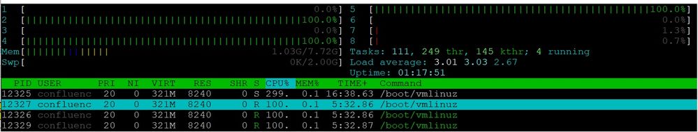

Do you know why that process is using CPU fully?
Confluence is downed and that is appeared.
what is that and how can i do?
I killed that every time but this situation is repeatly over and over...
Based on this, it seems like you might have been affected by a malware attack from the CVE-2019-3396 Widget Connector vulnerability from March 20th (see Confluence Security Advisory - 2019-03-20). Do you remember exactly when you upgraded Confluence? We started seeing attacks in the wild for this vulnerability on April 10.
Confluence 6.15.2 is a version that is patched against the vulnerability. It was released on April 5 so I am wondering if you maybe upgraded late last week (and possibly got infected with malware before upgrading).
If it was a malware attack, you'll still need to clean up the malware from the server. The LSD malware cleanup tool will be useful for removing the Kerberods malware, which we saw most commonly on April 10 specifically. Other malware payloads might need different cleanup tools depending on which attack and payload were used. A good starting place for detecting other types of infections are the scanners linked here. Once a particular infection is identified, googling for "____ removal tool" is a good place to start if the scanner was unable to remove the malware automatically.
