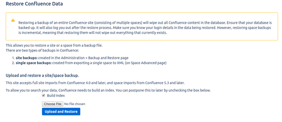

For you to be able to restore spaces in Confluence 6.12.2, the instance from where the spaces are coming from needs to be at least at Version 5.3.x. With this information, we now know that you can import spaces from your Old Confluence at 5.10.x or 6.0.7 version:

If your objective is to grab a space from
your old Confluence (Currently sitting at 6.0.7 per your question)
and import it into a newer Confluence (at version 6.12.2),
there should be no need to upgrade the old Confluence any further than this.
Let us know if this help you out!
