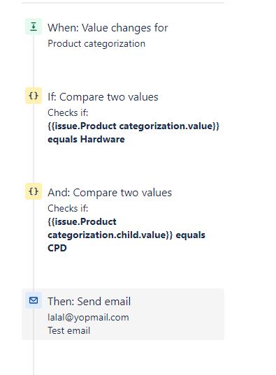

I'm interested in writing automation rules.
I have a certain field (Disposition) of "type Select list (cascading)" and I want that when it is filled "Anomaly-Acceptable"Screen Shot 2022-07-06 at 14.46.31.png and then I change the field to "Anomaly-Fix"
Screen Shot 2022-07-06 at 14.49.06.pngit will automatically send me an email.
Is it possible? If so I appreciate it if you could help me write this.

Hi @amit.bakst
Try the following automation rule:
The above rule was tested and works like a charm.
You just have to replace "Product categorization" with Disposition (Defect) and the values "Hardware" and "CPD" with the corresponding.
Alex
