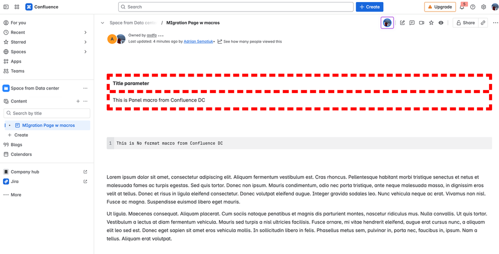

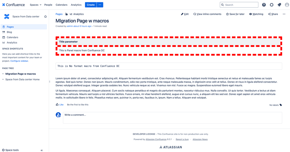

Hi @umashri
I am developer at Wombats Corp, and i find this question very interesting, so I tried it on my own.
I created page in DC with following macros
As @Trudy Claspill said, after migrating to Cloud, all of those macros rendered successfully in both the Legacy Editor and after updating the page. However, in the case of loremipsum, I couldn't find it in the macro browser.
So while the macro still works, it can’t be added to new pages through the macro browser.
