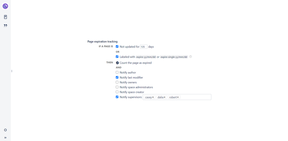

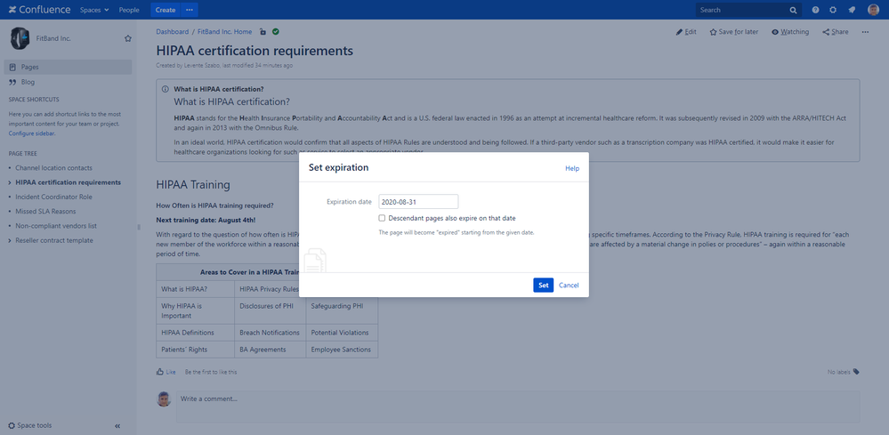

The app called Better Content Archiving for Confluence allows you select an expiration date for a page:
(You can set it to the date one day before the actual birthday.)
You can configure the notification to be sent to a list of hand-picked users in the "Notify supervisors" list:
As result, the supervisors will be emailed on the given day.
Note that it assumes that you create a separate page for each team member (which can be a good thing for other reasons, too).

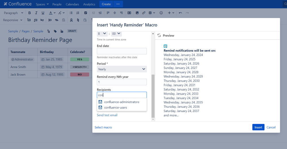

Hi @Manav Mrigank ,
Our Handy Reminder macro can be a good fit for your use case. Handy Reminder is a part of the Handy Macros for Confluence app. You can use it to create reminders with different settings based on your use case. You can set the reminder recipients, date and time for the notification (including the required repetition), or customize the look and feel of the reminder.
Thus, you can add our Handy Reminder and set it for the group of your users who need to get the notification once a year. I hope this is helpful. Feel free to contact our support for more details or to arrange the app demo.
